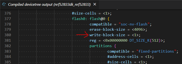

I am working on nrf52833 board, while working with flash in dts file i could see that write_block_size is 4 bytes. Is there any way to reduce that , i need it as 1 byte. kindly suggest me

You want to reduce the write_block_size. For that, you could use overlay file for your board.
Here is sample overlay:
&flash0 {
write-block-size = <1>;
Here is sample DTS output using such an overlay file.

thanks Naeem Maroof ,
Yes this one I have tried already. it will get update is .dts file (zephyr.dts ). However , while writing flash if I provide one byte it won't take it. it will generate error.
How are you writing?
Can you provide the code / zip-folder and log file if any.
I will try that here.
