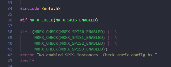

The code compiles just fine on NCS 1.9, but after migrating to NCS 2.0 I noticed that it doesn't recognize that I'm even using NRFX SPI drivers:
However my configuration does have these lines in the configuration:
It's probabbly something as simple as missing line in configuration. What am I missing?

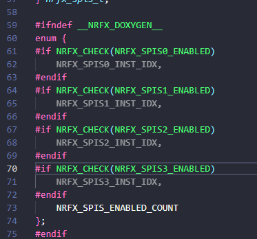

  • Yes, after switching to NCS 2.0 I get an error that identifier "NRFX_SPIS1_INST_IDX" is undefined therefore I am unable to compile it. Upon investigating this further I found that this define is missing (not compiled) because it doesn't pass this if in nrfx_spis.h file:

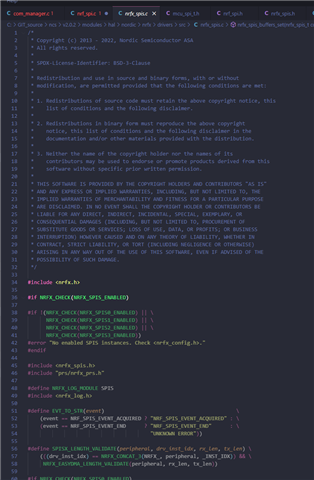

    As you can see from all the greyed out text the define is not included because it cannot pass this if. Upon investigating it even further i found that a whole nrfx_spis.c file is not included into build because it doesn't pass this NRFX_CHECK (also seen in first, initial post screenshot):
     I do not use any sample application, this application has been in development for a while. I figure something changed with the configuration which causes me to fail this 'if' and not include all the nrfx_spis.c file. So the question is what changed going from NCS 1.9 to NCS 2.0 that causes me not to include nrfx_spis drivers into the build?
