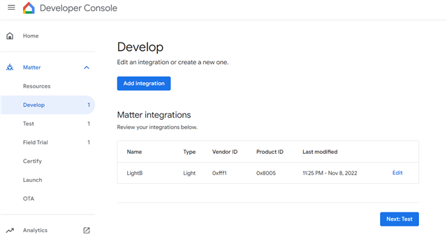

I have compiled Nordic Light Example for nRF5340-DK   and flashed it.
I'm using a border router based on beagle bone and OpenThread 1.3
On nRF5340-DK I have set up an active dataset (the same as BR).
When I'm sending ping 2001:db8:1:ffff::808:808   from nRF5340-DK I'm getting a nice response confirming my connection with the internet. I'm able as well to ping mobile phone IP from  nRF5340-DK.

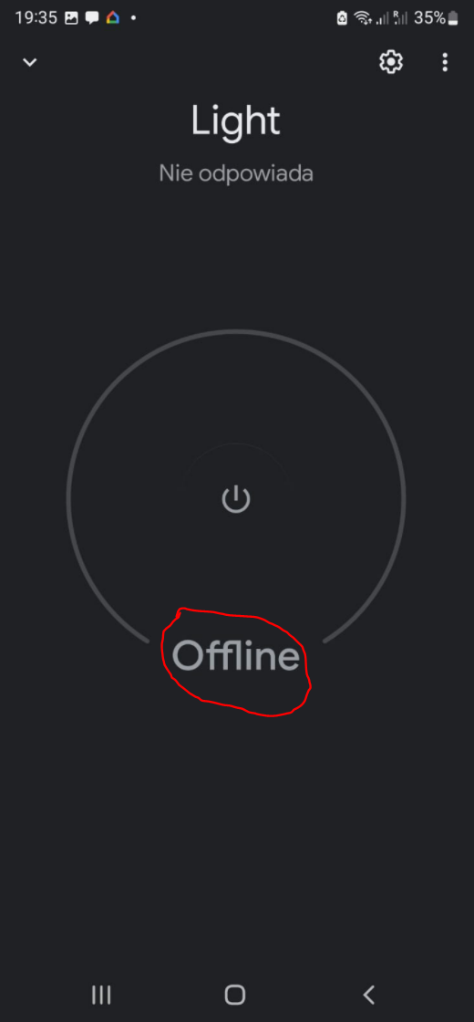

When I doing commissioning with Google Home app on phone after device discovery and scanning QR code I'm getting information that the device requires Thread Border Router (information in Polish language). It says that I should connect with Border Router and configure the device once again.
The problem is that this device already is connected to Border Router and has internet access, as proved by ping 2001:db8:1:ffff::808:808 and phone IP .
Below is log from my nRF5340-DK which I'm getting during this process.

In the google developer console, I have the below configuration. I also have to check if email address used in the developer console is the same one I'm using on my phone's Google Home App. Any idea why I have a problem with adding nRF5340-DK  as a device in Google Home App?  This is my first attempt to commission Matter device so I will appreciate any help.

  • Hi,  it looks like some flags sent to the cloud are not set all properly in Matter SDK  github.com/.../23761
    Just now installed fresh Nordic SDK v2.2.0-rc1. Still, the device is offline after successful commissioning.
    Does anybody know where I can find information on how I can fix the device's offline problem?
