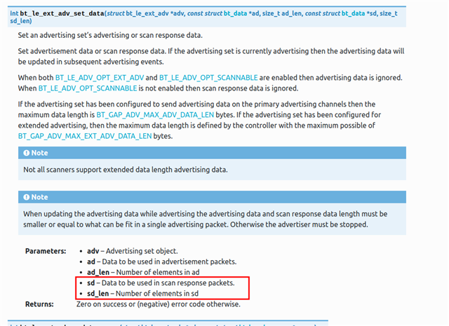

    your right, with BT_EXT_ADV_MAX_ADV_SET=2 I can have two advertising sets and I'm able to start extended as well as simple advertising. But there is a remaining question: Using the simple advertising alone, starting by means of bt_le_adv_start(..), I have the two arrays "ad" and "sd" for setting a number of flags and options. When starting the simple advertising in the "combined" mode by means of bt_le_ext_adv_start(..), I have just one parameter set. How can I manage the all the options from the simple example? I could create "ad" and set this data portion with bt_le_ext_adv_set_data(..), but how to handle "sd"?

  • Hallo Axel,
    You can pass your scan response packet to bt_le_ext_adv_set_data() too. From the API documentation:
    Vidar
