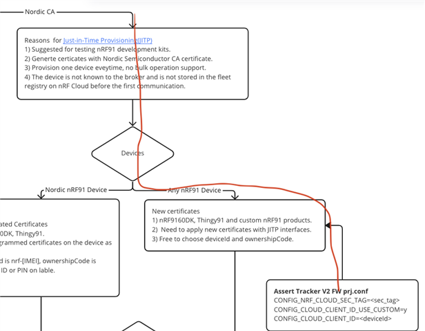

  • Hi Mhumannad,
    Great! Good to hear both SLM and XPING work on your device now.
    Next step, let´s provision your custom nRF9160 device with Just-In-Time Provisioning and run the Assert tracker V2 again.
    I have a guide about nRF Cloud Access Provisioning including Decision flow for nRF Cloud Provisioning. You basically follow the red line in the flowchart.
    Please pay attention that your custom board is not officially supported by Assert Tracker V2, so this application may be not fully functional on your board. but if you build with nRF9160dk_nrf9160_ns, we should at least see the device connect with nRF Cloud if you correctly provision the chip to nRF Cloud correctly. Let me see what you can get.

  • Hi Charlie!
    Thank you for the help! I followed the flow chart as mentioned
    https://miro.com/app/board/uXjVPfcfAd8=/
    Asset tracker_V2 prj.config file is

    # Default cloud transport service
    CONFIG_NRF_CLOUD_MQTT=y
    CONFIG_HW_ID_LIBRARY=y
    CONFIG_HW_ID_LIBRARY_SOURCE_IMEI=y
    CONFIG_NRF_CLOUD_SEC_TAG= 16842753
    CONFIG_CLOUD_CLIENT_ID_USE_CUSTOM=y
    CONFIG_CLOUD_CLIENT_ID="351358814108376"

  • Hi, charlie!
    Thank you for the help now Connected!  The issue was that I was not updating the certificates in
    C:\Nordic\myapps\asset_tracker_v2_2_0\src\cloud-certs
    thank you again for the help!
    Muhammad Usman
  • Hi Muhammad. Can you inform me which part in provisioning process to custom board that I define PIN for registering it to nrf cloud account? I already did provisioning process but still can't connect my custom board to nrf cloud, I receive wrong API Key, but I think I already did the process.
    Thank you.
  • Hi Azwawe
    As for pin # , you can enter any pin # , i entered 654321. have you added the certificates to the asset tracker v2 firmware which you downloaded from the LTE link monitor and nrf cloud ? because it must be necessary to load certificates to the FW else you will not able to connect to nrf cloud or even log in
    Muhammad Usman
