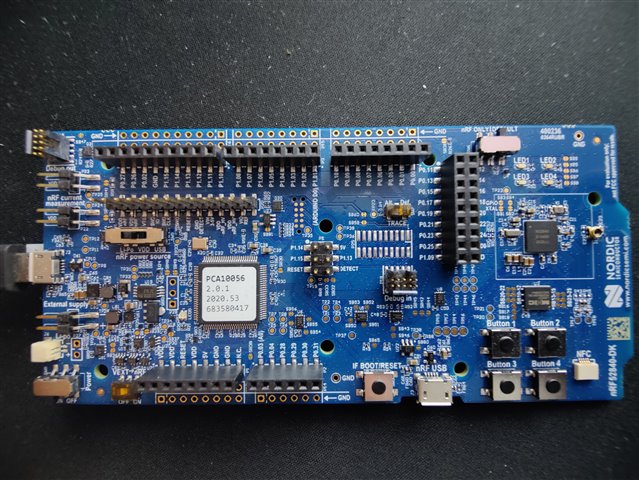

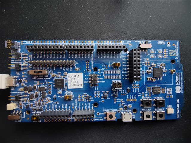

I use Linux with the nRF52840DK. I have three such developer boards, and only the one with the serial number 1050205291 exposes two ttyACM interfaces on Linux vs the other two boards with the serial numbers 683150769 and 68350417.
The processor of the 1050205291 board on which Segger runs is visibly smaller than the other boards, which might explain the difference.
In some situations, the two ttyACM interfaces are useful, so I'd like to use both on all my boards. For example, the "Bluetooth: Central UART" demo utilizes a ttyACM interface for logging and the other for communicating via UART.
Please let me know what causes the difference and how I can make all my boards expose two ttyACM interfaces.
  • Hi mlac,
    Regarding the two interfaces you observe with the rev 3.0.0 board, unfortunately that is just a known issue of the debugger firmware. Only one of them works. If you take a look at board's schematic, you will see that only one VCOM port is actually physically connected to the nRF52840 chip on the kit.
    Therefore, while having two interfaces is handy for various use cases, it is not actually possible with the nRF52840 DK.
    Which is why I am a bit surprised that you were able to use both ports for debugging the Bluetooth: Central UART sample. Are you sure you actually see both ports working as Serial/UART interfaces? The logging interface in that sample should be Segger RTT.

  • Hi Hieu,
    I can consistently reproduce this phenomenon. After flashing the Bluetooth: Central UART example, with this board:
    /dev/ttyACM0 and /dev/ttyACM1 appears.
    With this board:
    only /dev/ttyACM0 appears.

    BUT before you buy anything, I strongly recommend you to review your observation.
    Prior to my previous answer, I have checked the nRF52840 Rev 3.0.0 Schematic , and checked the Bluetooth: Central UART sample carefully.
    On the hardware, there is only one UART bus from the nRF52840 connected to the Interface MCU.
    On the sample software, there is only one UART port configured for the purpose of talking to the BLE UART Service, and the log is produced via Segger RTT.
    Your two ttyACM ports will always be there as long as you keep the board plugged in and powered on. However, only one of them would ever work.

  • Hi Hieu,
    I've just tried to reproduce the issue, and the second ttyACM interface of the rev 3 kit seems non-functional, indeed.
    Given the above, it doesn't make a difference whether I use the rev 2 or rev 3 kit, although I'll probably stick to my rev 2 kits because the extra non-functional ttyACM interface of the rev 3 kit slightly bothers me.
