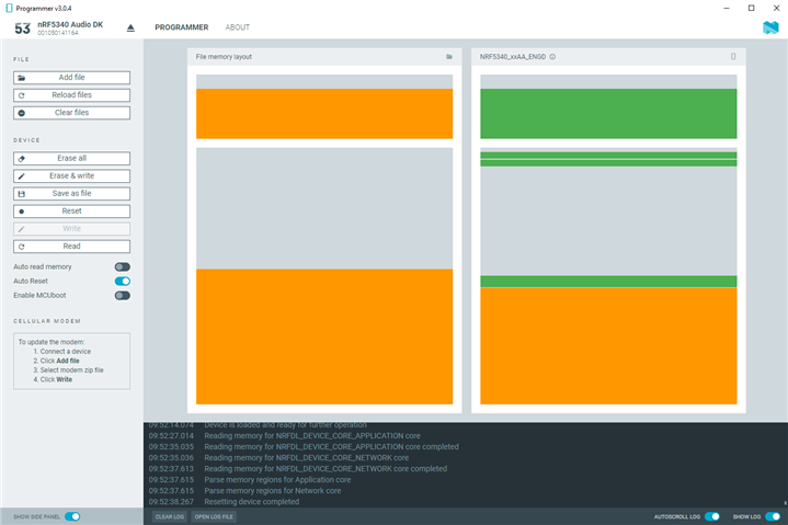

The problem is that the Headset crashes immediately on boot, blinks blue quickly, then goes to red. It has a kernel fatal error (reason: 3), ends up in k_sys_fatal_error_handler() when I debug.
The same problem does not exist on Gateway.
Using SDK 2.1.2, installed directly in C-dir, using windows and Python 3.11.0.
Using the buildprog script inside the sdk worked for compiling the example and configuring the files.
When uploading, I obviously have to flash both modem and processing core, so I used the Programmer, programming both the zephyr file and the "ble-ctr-rpmsg_3303.hex" for the modem.
Reading back, it would seem that everything is okay. (See picture)
I used the included json to configure before programming, see file below.
Included is also prj.conf for the headset.
As you can see, I'm running pretty much default everything, tried really hard to not do anything fancy or custom.
I'm really surprised that the example shouldn't work out of the box, so any help is much appreciated!

Programmer screenshot:
