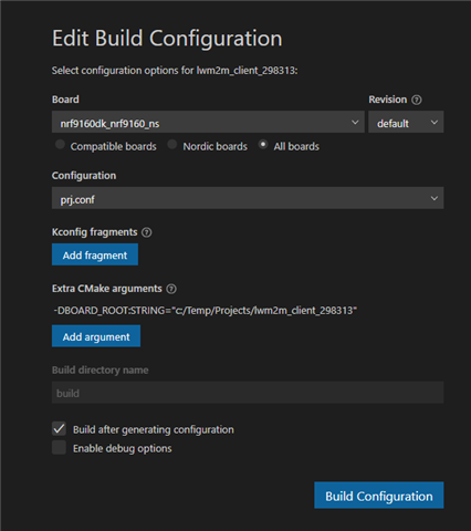

  • Hello Hassan,
    What configurations have you added to the project? Building the default sample for nrf9160dk_nrf9160_ns did not throw any error on my side.
    Øyvind

  • Hassan, I'm using nRF Connect SDK v2.1.2 from the Toolchain Manager. Created new application (freestanding) of the LwM2M client, built for nrf9160dk_nrf9160_ns
    -Øyvind

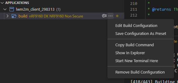

  • Hassan, can you please try to disable debug options in your build configuration? Do you need these for testing the sample?
    When you add a build configuration with this option checked, the following options are set:
    • CONFIG_DEBUG_OPTIMIZATIONS - This option limits the optimizations made by the compiler to only those that do not impact debugging.
    • CONFIG_DEBUG_THREAD_INFO - This option adds additional information to the thread object, so that the debugger can discover the threads. This will work for any debugger. Additional threads appear in the Call Stack View.
    Enabling the debugging options will affect the application's memory usage.
    From the nRF Connect for VS Code documentation on Enabling debugger
  • HI, I have deleted the previous build and changed it to a build without debug options checked.

  • I am not able to reproduce this. I edited build configuration:
    and unchecked Enable debug options
    Then clicked build configuration, which ended with a complete build
               FLASH:      294492 B     409088 B     71.99%
                SRAM:      106712 B     211736 B     50.40%
            IDT_LIST:          0 GB         2 KB      0.00%
    [435/443] Generating zephyr/tfm_nonsecure.hex
    [436/443] Generating zephyr/mcuboot_primary_app.hex
    [437/443] Generating zephyr/mcuboot_primary.hex
    [438/443] Generating ../../zephyr/app_update.bin
    sign the payload
    [439/443] Generating ../../zephyr/dfu_application.zip
    [440/443] Generating ../../zephyr/app_signed.hex
    sign the payload
    [441/443] Generating ../../zephyr/app_test_update.hex
    sign the payload
    [442/443] Generating ../../zephyr/app_moved_test_update.hex
    [443/443] Generating zephyr/merged.hex
