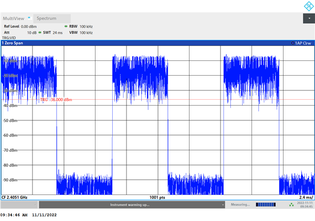

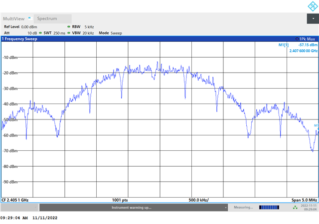

During the tests, we noticed that the module transmits the desired frame but then emits a non-modulated signal in some conditions:

  • We tried to slow the rate at which we emit the messages. In my software, if I emit a message each >=30ms, the issue disappears. If I emit a message more frequently than >=30ms, the issue starts to occur.

Below some screenshots of the spectrum analyzer we did to show you the issue:
  1. TX - Temporal - Message each 30ms
  2. TX - Temporal - Message each 5ms
  3. TX - Spectral - Message each 30ms
  4. TX - Spectral - Message each 5ms
