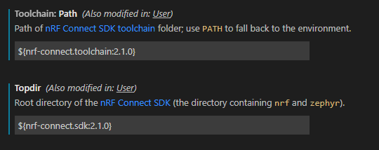

    After experiencing numerous problems with trying to use VS Code with nRF Connect SDK v2.1.2 and v2.1.1 ,  I have removed these two installations from my PC and I have installed a new: nRF Connect SDK v2.1.0 in the new folder: c:\Nordic-210\...
    I then opened the VS Code from nRF Connect SDK v2.1.0 in the Toolbox Manager v1.2.1 and as usual, I saw the message: "Invalid Python executable" that I already showed in my previous email.  I clicked on the "Configure..." button at the bottom of this message but at the top of the screen, I still saw the message: "Last sync: 1 wk ago".
    I attach a screenshot od that message.
    I then clicked  on "Create a new application" on the "New Application" page. I then selected:
    1. Application Type: Freestanding
    2. nRF Connect Toolchain: 2.1.0 (c:\Nordic-210\toolchains\v2.1.0)
    3. Application Location:  c:\Nordic-210\my_blinky_3
    4. Application Template: zephyr\samples\basic\blinky
    5. Application Name:  blinky_3
    6. nRF Conect SDK:
    I wanted to ensure that under the nRF Connect SDK, I  would enter: "version 2.1.0" that I just installed, but I was unable to do so, as per the message shown below that setting, that stated that :
    " An SDK is inferred from the workspace, so another cannot be selected".
    So, despite me removing the installation of the nRF Connect SDK v2.1.1 from my PC and replacing it with the nRF Connect SDK v2.1.0 - I could not select this newly installed version of nRF Connect SDK v2.1.0 , but I was forced instead to retain (for this selection) the old version of the nRF Connect SDK v2.1.1 that I just removed/uninstalled from my PC.
    Why???
    Could this be a part of the problem that I am experiencing?
    If this SDK v2.1.1 is inferred  from the workspace , then what can I do to ensure that my latest choice of the nRF Connect SDK , namely version V2.1.0 will be inferred from the workspace ?
    I attach a screenshot of the "New Application" page, with the message: " An SDK is inferred from the workspace, so another cannot be selected".
    And then, when I tried to build this application, the usual Error messages appeared again as per the attched screenshot: "Error messages after an attempt to build the application":
    "error: Aborting due to Kconfig warnings",  "FATAL ERROR: command exited with status 1".
    What shall I do to be able to start using the VSCode for building my applications again?
    JM

  • Hi
    Your old settings are still retained in VS Code after you uninstall NCS.
    Please go to File>Preferences>Settings>Workspace>Extensions>nRF Connect and update your settings.
    Here's mine for reference:
    There's a Kconfig Python setting here you should probably also consider setting to something reasonable. Mine is empty (Sync ignored).
    -Einar
