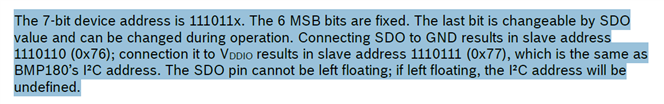

As you can see i2c0 has got a node named mysensor whose i2c address is 0x76. This is what I have found inside the bmp's datasheet in order to choose the right address:
Here you can see the bmp280's pins:
I connected SDO to GND so that the device address is 0x76. As for the rest, here's my physical connections:

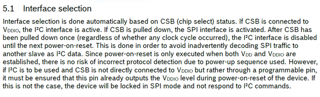

  • CSB-->VDD
I decided to tie CSB high because I read this inside the datasheet:

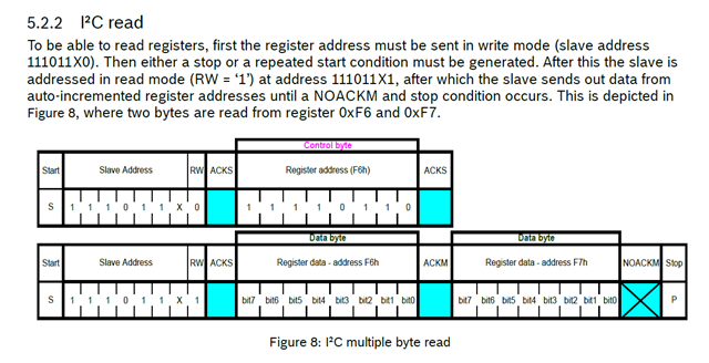

You are probably wondering about the content of vector sensor_regs...
0xEC should be the first address to be sent according to the following notation...
0xD0 is the address of the id register which I would like to read.
