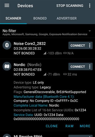

  • Hi Joakim,
    1. Initially when we are advertising (advertising_init  function) with both service data and manufacturing data, we are able to see the device full name in advertisement.
    Initially it is working fine. That you can see in the following image.
    Once I update the manufacture data and service data with the  same length, the following error coming.
