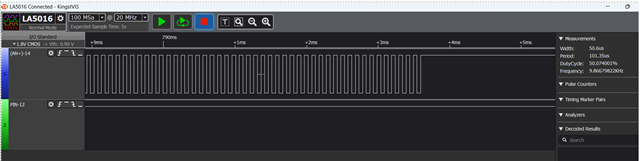

  • Could you tell me what is the fastest sampling frequency for “Comparator different and high speed” mode?
    My "AN+" connected 10K hz 1.8V square wave, "AN-" connected 1.25V, but the output pin didn't output, I think frequency is faster than MCU comparator. thanks
    Looking at the LPCOMP chapter in the PS,  https://infocenter.nordicsemi.com/topic/com.nordic.infocenter.nrf52832.ps.v1.1/lpcomp.html?cp=4_2_0_38_3_0#unique_1187726518 ,
    We have that "Time from VIN crossing (>=50mV above threshold) to ANADETECT signal generated." is typ 5us, i.e. max frequency is 200kHz.
    Could you show the code you use for this?
