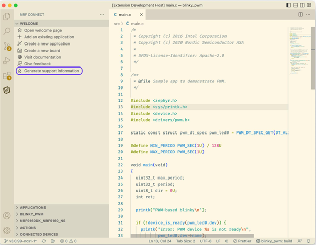

  • Could you please send us the support information? You can generate it by clicking as shown in the screenshot.

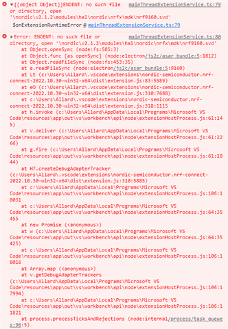

    It would also be helpful if you could open the Developer Tools and see if there are any errors in the console. You can find it by clicking ''Help'' and and then ''Toggle Developer Tools'' in the main bar. Then you have to click the Console tab in the window that opens.
  • See attachment for the support info, I've cut some sensitive data and replaced it with '<CUT>'. Somehow "config"/"applications" contained a path to a whole other project.
    The devtools log shows soms errors, also an error about nrf9160.svd, I think this is the file that the debugger needs to properly show peripheral registers? The path that is tries the access is correct, but the drive letter (D:\) is missing.
