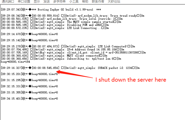

nrf9160 mqtt sample disconnect state update
Hi:
I use mqtt_ Sample routine: MQTT is connected to the server, and I shut down the server. At this time, the 9160 status has not been updated, but is still connected. Sometimes it takes several hours to refresh the status.
Kconfig file
config MQTT_KEEPALIVE
	int "Set keepalive"
	default 60
Sometimes it takes several hours to wait for this state:
[15:56:23.863]收←◆<inf> mqtt_simple: MQTT client disconnected: -113[0m
[00:38:02.900,573] [1;31m<err> mqtt_simple: ERROR: mqtt_live: -113[0m
[00:38:02.900,604] [0m<inf> mqtt_simple: Disconnecting MQTT client...[0m
[00:38:02.900,726] [1;31m<err> mqtt_simple: Could not disconnect MQTT client: -128[0m
[00:38:02.900,756] [0m<inf> mqtt_simple: Reconnecting in 60 seconds...[0m
