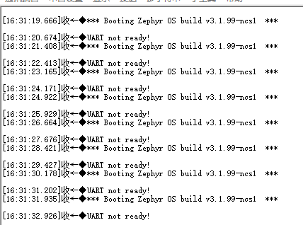

  • Hi:
    I changed it to this, but it failed and kept resetting.
    void uart_init(void)
        uart = device_get_binding(DT_NODE_FULL_NAME(DT_NODELABEL(uart1)));
        if (!device_is_ready(uart)) { printk("UART not ready!\n"); }
        user_uart_rx_enable();
  • Hi
    Could you share the content of your UART1 node from your devicetree found in build/zephyr/zephyr.dts?
    Einar
  • UART1 is disabled by the nrf9160dk_nrf9160_ns board definition, see UART1
    /* Disable UART1, because it is used by default in TF-M */
    &uart1 {
        status = "disabled";
    Your log indicates that by "UART not ready". I guess , your variable "uart" is therefore still NULL.
    If the uart is not available, and your variable is NULL, you can't call user_uart_rx_enable, it will not work anyway.

  • You have enabled both UART1 and I2C1 (TWI1), while your error message stated pretty clearly you cannot do this.
    Have you considered using another uart than UART1?
    -Einar
