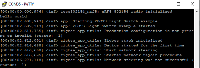

    I use your nrf52840dongle_nrf52840.overlay and create nrf52840dongle_nrf52840.conf under \boards with the following content:

    modify main.c as

    Get log as

  • Thanks. The problem seemed to be a missing pm_static.yml file.
