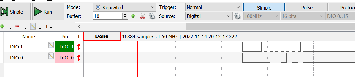

A problem with I2C on NRF52840 using Instance NRF_TWI1
Hi experts,
 I habe a following issue. First I have tried to use nrfx_twi driver. There was any data send over I2C...
So I have written own driver using the Datasheet and also received a problem. After sending the data
the RX interrupt is rising. Which causes a logical error. How th driver was realized:

After initialization the following data was send:
uint8_t i2CTxBuffer[2];
i2CTxBuffer[0] = 0x35;
i2CTxBuffer[1] = 0x70;
// send to addess 0x3C, to register 0x35, value 0x70
nRF52_I2C_TX(0x3C, i2CTxBuffer[0], &i2CTxBuffer[1], 1);
As can be seen of  the figure below, the TWI do not generate any start/stop conditions. The first and the last byte is send if 0x35. After the firts byte were proessed
the TWI genareted EVENTS_RXDREADY event. Which does not pass, and causes an internal logical error...
Scope picture
Could you explain, what I'm doing wrong?
