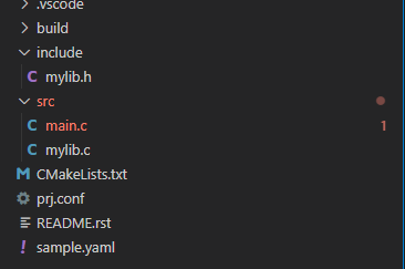

  • Hi Brown,
    Are you actually trying to create an "external static library", or are you simply trying to create some header and source files for your project?
    To include files according to the way you described your directory structure, you can update your cmakelists.txt with this:
    target_sources(app PRIVATE
        src/main.c
        src/mylib.c
    include_directories(
        include
    and then add
    #include "mylib.h"
    in your main.c.
    and then place your files like this:
    I have created a zip files of the hello world sample modified to call hello world from a library:
    hello_world_library.zip
    Does this answer your question?
    Raoul
  • Hi Raoul,
    Like you did, I included the "target_sources" and "include_directories" lines in my src/myproject/myboard/Cmakelists.txt and the "#include "myfunctionsandvariables.h"" line in my main.c. I should have clarified this in my original question. My file structure up above seems to match the structure in your picture, which is good.
    Let's say I define "void myfunc(void)" in myfunctionsandvariables.h and myfunctionsandvariables.c. I can successfully call myfunc() in main.c, but I cannot call this function in something like the Connect SDK library's azure_iot_hub.c or aws_iot.c.
    How could I call myfunc() in azure_iot_hub.c or aws_iot.c?
