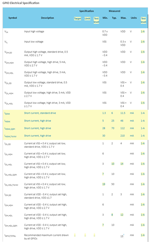

I got feedback from our team. Our product specification does not specify the high drive mode for MAGPIOs. Therefore, I_OH, SD and I_OL, SD in GPIO specification should be valid for MAGPIO => max current 1mA when 1,7 < VDD < 2.7V
