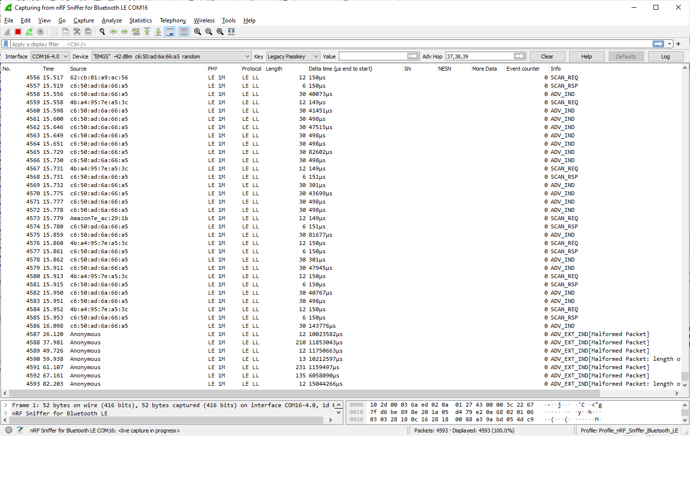

    I've installed the nRF Sniffer tool and tried to check the ble communication. However, only advertisement messages are captured and no packet can be captured after the device is connected to the phone. Could you give us some suggestion about how to capture the ble packet after connection?
    Thanks again for your kindly help.

  • Hello Hang,
    Glad to see that you have the sniffer up and running!
    When you have selected the device in the device dropdown menu (like you have), the sniffer will follow this specific device. If this device then enters into a connection the sniffer will sniff the key, and also follow into the connection.
    However, if the device is already bonded with the central it will not exchange keys on air, and so the sniffer can not follow them.
    These different cases are also mentioned in the Sniffer documentation on the Infocenter - please have a look to see which case that aligne with your application, and use the described procedure to make the sniffer follow into the connection.
    Which type of encryption / pairing process are you using for your EMGS device?
    For future reference, please share the sniffer trace files directly, instead of screenshots. Screenshots inhibits us from properly looking through the trace on our end.

  • Hello Karl,
    I've selected the device in dropdown menu before connecting the device to the phone, the sniffer can finally capture the packets after connection established.
