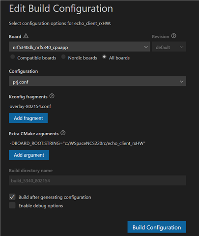

    Both build configs are set up like this:
    FYI I noticed that the new release candidate of the SDK was using zephyr 3.2 which no longer requires IP so ran this test there but the same message occurs.

  • Richard said:
    This should probably be in a new ticket - but where does the build config setup get saved so that it I could have included that in the files sent? Best guess is it'll be part of the VS Code workspace file?
    You can right click on the build "folder" in VS Code, and select "Save configuration as preset", which will create a .json file in your application folder. If you create a new build configuration in a project folder where this .json file is present, you will get the option to generate from that preset.
    However, your echo-client.c has, on line 23:
    #include "nrf_802154.h"
    but the compiler doesn't know where to pick it up from. Did you copy this file and paste it somewhere in your NCS repository?
    Can you please try to build it in a pristine version of NCS to see if you get the same error?
    Or can you upload your .json file?
    BR,
    Edvin
  • I've not done anything with the nrf_802154.h file manually. I've just done a pristine build on the 2.2.0rc on my laptop which I installed yesterday so no updates and that was fine.
