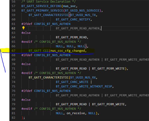

have done the "nRF Connect SDK Fundamentals", course and have create a custom characteristic to read and write but I cannot get notification to work.
I'm using nRF Connect SDK (vsCode) and nRFConnect to view the BLE output on my iPhone.
I'm based this off zephyr/samples/bluetooth/peripheral and just removed code that I don't need and added a bit. I thought that I was just following the heart rate code with slight changes but I must be missing something. In the nRfConnect app I press the two down arrows and nothing happens to the Value. I'm firing of a notification every second.
If anyone has an example for a custom notification that I can study that would be great, or with the code below can see what I am missing that would be great also.
Also how would I debug this?

  • Hi Paul,
    From what I can see in the code is that you have a characteristic with notification permission. But you haven't defined a CCCD characteristic so that the client can enable notification for the characteristic above it.
    If you have a look at the NUS service (\nrf\subsys\bluetooth\services\nus.c) in peripheral_uart  sample you can find this:
    Also there were two more issue with notify_adc(), first is that you are sending to attribute handle &adc_svc.attrs[1] which is the declaration of the characteristic, not the value. And secondly, you are trying to send 21 bytes when the maximum is 20 bytes (if you don't use data length extension, max data length is 23 bytes and with 3 bytes overhead you have 20 bytes left )
    This would work:
    static void notify_adc(void){
    	printk("notify adc2 ");
    	static uint8_t level[20] = { 'a', 'b', 'a', 'a', '8', 'a', 'a', 'a'};
    	int rc;
    	rc = bt_gatt_notify(NULL, &adc_svc.attrs[2], &level, sizeof(level));
    	return rc == -ENOTCONN ? 0 : rc;
    With this in the declaration:
    BT_GATT_SERVICE_DEFINE(adc_svc,
    	BT_GATT_PRIMARY_SERVICE(&notification_uuid),
    	BT_GATT_CHARACTERISTIC(&adc_notify_uuid.uuid, BT_GATT_CHRC_NOTIFY,
    				BT_GATT_PERM_NONE, NULL, NULL, NULL),
    	BT_GATT_CCC(NULL,     BT_GATT_PERM_READ | BT_GATT_PERM_WRITE),

  • Hi Paul,
    I think it's my mistake. Either handle, characteristic declare or characteristic value would work. So in your case adc_svc.attrs[1] and adc_svc.attrs[2] would work.
    I was having the impression that adc_svc.attrs[1] doesn't work but it was because the length was 21 at that point. It was not because of adc_svc.attrs[1].
