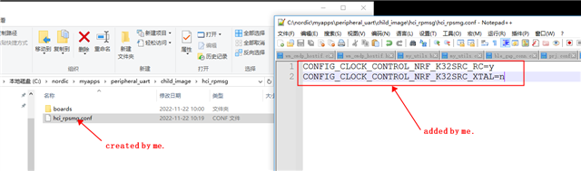

Hi. I'm using nrf5340.  I confirm internal clock(LFRC RC osc) exist,I  want to remove external 32.768kHz X-tal. If yes, how can I turn on LFCLK RC oscillator in my source code?
my ide is vscode,and SDK version is v2.0.0. example project's name is peripheral_uart.
