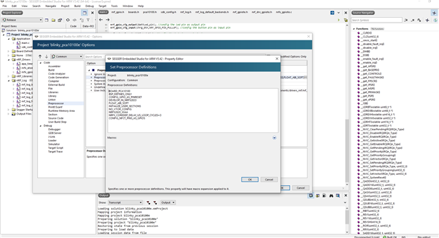

I am using customized nRF52833 DK with PCA10100 on it and s140 soft device version..
While reading the pin status, it is not changing value according to the switch position.
Please

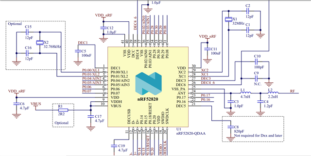

    You're developing for the wrong board, PCA10100e is for the nRF52820 simulated on the nRF52833 DK not the nRF52833.
    The nRF52820 doesn't have P0.09 and P0.10, which is why it doesn't work on your board.
    For starters, you can try to remove NRF52820_XXAA DEVELOP_IN_NRF52833 and add NRF52833_XXAA. You might need to do some further configurations, but this should a good start..
