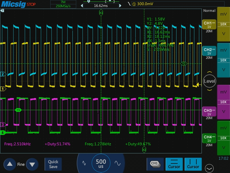

i am using 5340 + ncs 2.0.2. and gpiote nrfx drvier.
i used gpiote for count encoder
encoder clock speed is about 2.5k and input pint is 2 gpiote pin.
gpiote polarity is toggle.
gpiote pin number : A is 46, B is 47
pin B (number 47) is working good. but pin A (number 46) is detect slow less a half speed than pin A.
last test, I used pin 22,36 it work.
is there some limit about pin 46?
under below, code and screenshot
