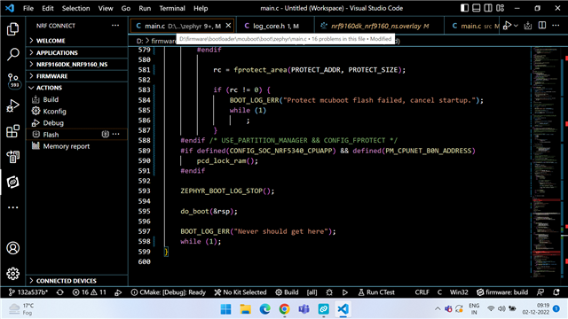

    this did not resolve the issue. I observed that in the mcuboot main.c file, inside doboot() finction, there appears some issue (see image 1). When step-in into doboot(), I found that the error occurs when at line number 274,
     ((void (*)(void))vt->reset)();
    is executed (see image 2). I could not analyze, what is done by ((void (*)(void))vt->reset)();. After reaching to this line, when F11 is pressed, the code enters to reset.S file, see image 3.  Step-in in this file and reach to line number 153 (Image 4). Press F11, code enters prep_c.c. At last line of this file, inside z_start() function, code changes to cmsis_gcc.h and
    __ASM volatile ("MSR msp, %0" : : "r" (topOfMainStack) : );
    causes fatal error.
