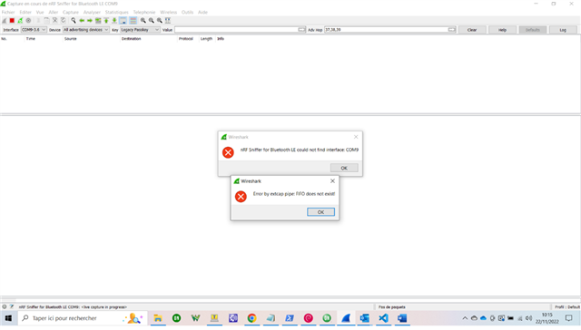

I installed Wireshark 4.0.1 with the Sniffer plug-in (i followed the instructions provided by Nordic) which has never detected the com interface.
I installed the previous stable version 3.6.9, the interface nRF Sniffer for Bluetooth LE COM9 is displayed, however when i start the capture i have errors pop-ups as shown in snapshot below. Sometimes, the interface is not displayed (detected),  i have to close/reopen Wireshark.
(Error by extcap pip:FIFO does not exist!)
(nRF Sniffer for Bluetooth LE could not find interface: COM9)
I have reinstalled Wireshark along npcap. I covered also the troubleshooting section from the doc nRF_Sniffer_BLE_UG_v4.1.x.pdf.
I have not updated JLink to the latest version as a installed the versin expected by Programmer app.
Has someone encounted the same issue with a fix, or could someone provide successful setup (combo wireshark/Jlink version)? I continue to investigate from the error info but without success so far.
