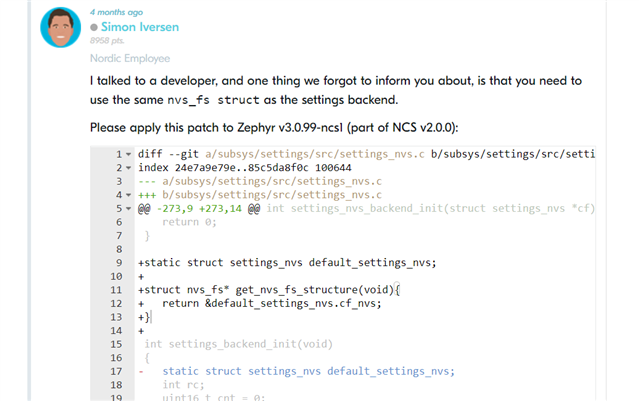

Maximising littlefs flash storage space
I'm working on a project that uses BLE, NVS storage (for some serial number data and a few other variables) and littlefs, for storing log data that a client can then access over bluetooth via SMP.  I'm on nRF Connect v2.0.0 and am using an nRF52832.
But I'm coming into some problems with making maximum use of the available NVS storage for my information.  At the moment, this is how my static partitions are defined:
settings_storage:
  address: 0x7a000
  placement:
    before:
    - user_storage
  region: flash_primary
user_storage:
  address: 0x7c000
  placement:
    before:
    - littlefs_storage
littlefs_storage:
  address: 0x7e000
  placement:
    before:
    - end
Ideally, I want to maximise the amount of littlefs storage, and reduce the settings and user storage to an absolute minimum.  But the user_storage needs at least 2 sectors, each of 4kB (a page) in size, even if I only need to store 200 bytes of info.  Similarly, it seems the settings area needs a similar amount as a minimum, because the moment I try and reduce that, my BLE functionality stops working.  This is only leaving me 8kB of littlefs storage.
Reading this, it seems its possible to combine the settings and user storage areas into one, which potentially would free up 8kB.  But I don't believe this has been implemented in v2.0.0, so I may need to upgrade to a newer SDK (I think its available in v2.1.2).  Question I have though is how do I actually implement this in my code?  I've just followed the nvs example to set up my user storage in my code, so it looks something like this:

  • Hi Mike,
    If you had a look at Simon example in the case you pointed to you can see that he added a patch to the Zephy's settings library to add this function get_nvs_fs_structure()
    It's to to get the instance of nvs used by the settings module so that you can store your own nvs data.
    In newer SDK (my test v2.1.2) this patch has already been implemented. You can call settings_nvs_storage_get() to get the nvs instance used by settings. After that you can nvs_mount the nvs instance that you get from the function. Please have a look at the example by Simon.
    This way you don't need to have an extra user_settings and can save some space.
    In the second ticket that you referred to I don't think the customer merged littlefs and nvs to use one partition, but it's more about not using nvs at all and simply use littlefs to store data instead of using nvs.
    If you need more space for your own data, have you considered to move the settings partition lower in flash for example 0x70000 instead of 0x7a000 ? Of course the trade off is that you will have smaller MCUBoot primary and secondary partitions.

    However, I am having issues with the call to
    default_config_nvs.cf_nvs = settings_nvs_storage_get();
    The compiler isn't able to find the API settings_nvs_storage_get(); even though I've got settings/settings_nvs.h included.
    I'm also not clear on what I should be passing to settings_nvs_storage_get(); to get it to return the correct info.
    I may actually be on the totally wrong path here as well!

  • Hi Mike,
    My bad, settings_nvs_storage_get was a static function for settings_nvs.c
    You should call
    settings_storage_get() instead.
    So the following code seems to work for me:
    static struct nvs_fs *fs;
        settings_load();
    	settings_storage_get(&fs);
    		rc = nvs_mount(fs);
    		if (rc) {

  • Hi Hung,
    Thanks - I've tried to implement this in my code, with SDK v2.1.2, but moving from v2.0.0 to v2.1.2 seems to cause my code to stop working as expected, so I'm not able to progress things.
    I'll need to do some more investigating as to what the issue is with the move from v2.0.0 to v2.1.2. before I can check if the above works for me
    Cheers,
    Mike
  • Hi Hung,
    Managed to update to NCS V2.2.0 and after much stuffing about, now have my code building.
    However, when I go to make the above changes to enable me to try and combine the settings and user storage into the one partition, I get the following build warnings:
    c:\Nordic\Development\LSR-MAX\LSR-MAX_V0_09\src\nvs_app.c:250:30: warning: passing argument 1 of 'settings_storage_get' from incompatible pointer type [-Wincompatible-pointer-types]
      250 |         settings_storage_get(&fs);
          |                              struct nvs_fs **
    In file included from C:\Nordic\v2.2.0\zephyr\include\zephyr\storage\flash_map.h:261,
                     from c:\Nordic\Development\LSR-MAX\LSR-MAX_V0_09\src\nvs_app.h:17,
                     from c:\Nordic\Development\LSR-MAX\LSR-MAX_V0_09\src\nvs_app.c:14:
    C:\Nordic\v2.2.0\nrf\include\flash_map_pm.h:31:17: note: expected 'void **' but argument is of type 'struct nvs_fs **'
       31 | #define storage settings_storage
    C:\Nordic\v2.2.0\zephyr\include\zephyr\settings\settings.h:606:33: note: in expansion of macro 'storage'
      606 | int settings_storage_get(void **storage);
    [288/309] Linking C executable zephyr\zephyr_pre0.elf
    My code is set up as follows:
    settings_load();
    rc = nvs_mount(fs);
    if (rc !=0)
    	printk("ERROR: Flash Init failed\n");
    	return rc;
    If I ignore the warnings and flash my code to my device, it just goes through an endless reboot cycle (I suspect I'm trying to write/read somewhere I shouldn't)
    Any ideas on what's going wrong?
    Cheers,
    Mike
