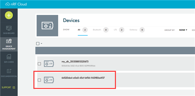

I have created my own UUID, CA certificates and Device certificates by using the python scripts in <nRFCloud/utils: Utility code/scripts for working with nRF Cloud (github.com)>
And I have provisioned the UUID to the nRF Cloud successfully, since I can see the UUID in the Device Pannel of the nRF Cloud portal. I used  "ProvisionDevices" Endpoint to do that.

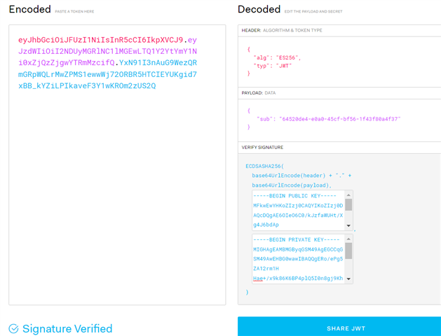

I created the JWT in jwt.io, follow the steps in the tutorial, like this:
the HEADER is ES256, the PAYLOAD is UUID, and the signature is generated by Device certificate. All the same with the tutorial above.
But when I call the GetAssistanceData endpoint using the JWT, it always returns Error Code: 40100.
The command I use is:
curl --request GET \
  --url 'https://api.nrfcloud.com/v1/location/agps?requestType=custom&customTypes=1%2C3%2C4%2C6%2C7%2C8%2C9&mcc=310&mnc=410&tac=36874&eci=84485647' \
  --header 'Accept: application/octet-stream' \
  --header 'Authorization: Bearer eyJhbGciOiJFUzI1NiIsInR5cCI6IkpXVCJ9.eyJzdWIiOiI2NDUyMGRlNC1lMGEwLTQ1Y2YtYmY1Ni0xZjQzZjgwYTRmMzcifQ.YxN91I3nAuG9WezQRmGRpWQLrMwZPMS1ewwWj72ORBR5HTCIEYUKgid7xBB_kYZiLPIkaveF3Y1wKROm2zUS2Q' \
  --header 'range: bytes=0-500'
The result is Always:
{"message":"Invalid JWT","code":40100}
I want to know what is missing or in wrong configuration. Thank you.
