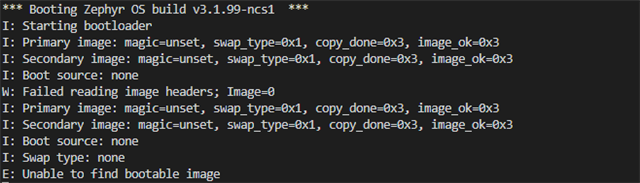

But i can not erase flash area s1 by flash_area_erase() and img_mgmt_impl_erase_slot().
Using flash_area_erase() i got bus falut and img_mgmt_impl_erase_slot() is not erase flash area s1 actually.

    can you please include the log output of the bus fault?
    This is bus falut log(flash_area_erase()):

    [00:00:05.012,145] <err> os: ***** BUS FAULT *****
    [00:00:05.012,176] <err> os:   Precise data bus error
    [00:00:05.012,207] <err> os:   BFAR Address: 0x18000
    [00:00:05.012,237] <err> os: r0/a1:  0x00000001  r1/a2:  0x0000d000  r2/a3:  0x00000002
    [00:00:05.012,268] <err> os: r3/a4:  0xffffffff r12/ip:  0x0000d000 r14/lr:  0x00033037
    [00:00:05.012,298] <err> os:  xpsr:  0x01000000
    [00:00:05.012,298] <err> os: Faulting instruction address (r15/pc): 0x0003303a
    [00:00:05.012,390] <err> os: >>> ZEPHYR FATAL ERROR 0: CPU exception on CPU 0
    [00:00:05.012,451] <err> os: Current thread: 0x20000260 (ota_mod_thread)
    [00:00:05.112,121] <err> fatal_error: Resetting system
