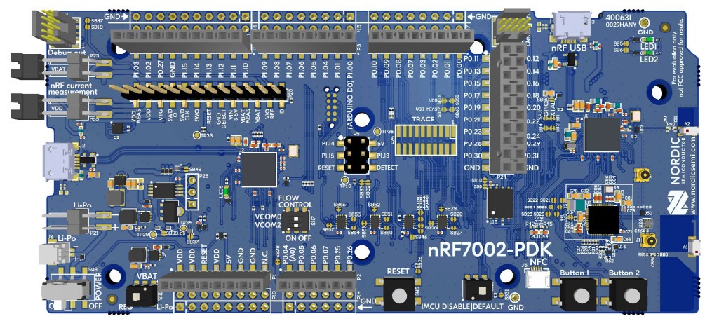

please I have to build a container for these two PCBA:
https://www.nordicsemi.com/Products/Development-hardware/nrf9160-dk
https://developer.nordicsemi.com/nRF_Connect_SDK/doc/latest/nrf/ug_nrf7002.html
these two PCBA must to be stored in the same craddle with the access to the USB connectors.
Please, do you have something already customized for this issue?  Plastic container, plastic craddle, etc.
thank you very much
best regards
Alessandro

  • Hi Alessandro,
    2185.step
    Here is the step file for the nRF9160-DK.
    I also discovered that my colleague had already designed an enclosure for the nRF9160-DK. I encouraged him to share it: https://www.thingiverse.com/thing:5671338
    If you design your enclosure for the nRF9160-DK, you can expect it to fit the nRF7002-DK will fit as will. The pins and standoff-holes all follow the format of the Arduino Uno.
    The nRF7002 is mostly identical to our nRF52840-DK. Only the lower right corner is shaped differently, to accommodate the antenna design:
    By the way - almost all of our hardware files are actually available for download. Among the nRF9160-DK files you will find 400389.PcbDoc which can be open in Altium Designer. From there, you can export the file as for example .step.
    If no one on your team has Altium, you can try opening it in the Altium online viewer, which I believe has an export function if you create a free account.
    You could also try opening the file in KiCad, and exporting the 3D model from there.
    For the nRF7002, unfortunately there are no downloadable hardware files available yet, as it is still in limited preview.
    Hope this helps!
