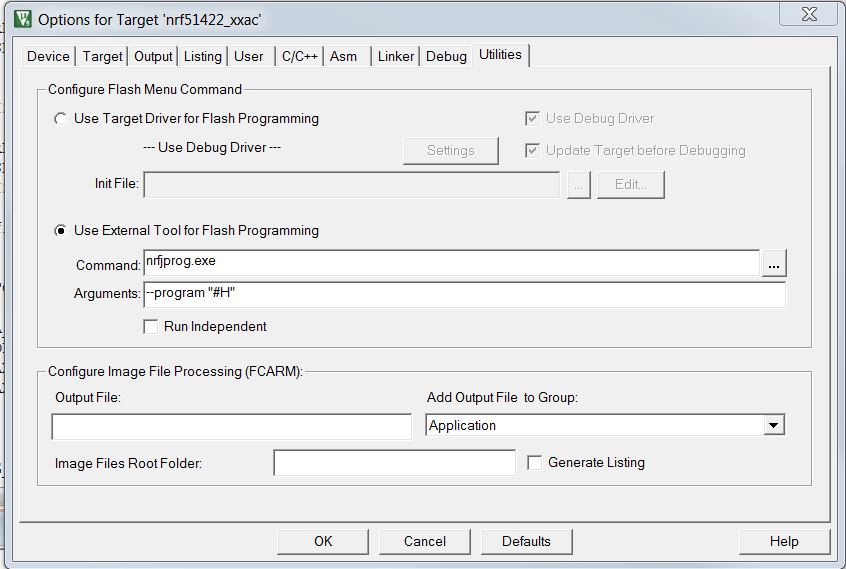

    Keil runs nrfjprog.exe in the the background when programming the bootloader. I have the following arguments set in Keil to program the bootloader

  • This worked but in order to get the debugger to work in the DFU I had to: 1- Build the DFU in Keil uVision 5 and enter the debug mode (which loaded the DFU source code into Keil's debugger). 2- Exit the debugger, and use the nNRgo Studio's Program Bootloader tab to load the bootloader 3- Go back to uVision and click the debugger button. At which point I could use the debugger.
    I do not understand why, but in order to get the debugger to run I had to load the DFU with nRFgo Studio.
