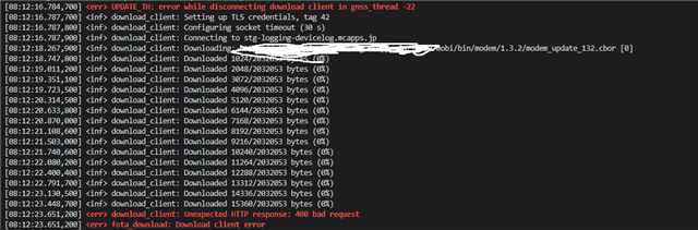

download_client: Unexpected HTTP response: 400 bad request
Hi there!
I am facing "<err> download_client: Unexpected HTTP response: 400 bad request" error
whenever I am trying to download full modem update from AWS S3 bucket.
My environment

	ret = fota_download_start(DOWNLOAD_HOST, mc_api_buf, TLS_MC_API_SEC_TAG, 0, 1024);
	if (ret != 0) {
		LOG_DBG("fota_download_start() failed: %d", ret);

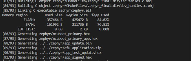

Error log
build log

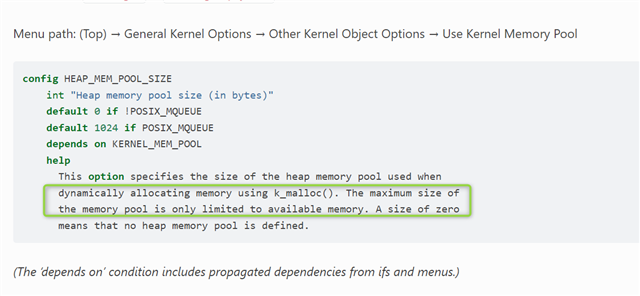

I feel,
CONFIG_HEAP_MEM_POOL_SIZE=29696
this above config in prj.conf is causing the problem.
Please help me in resolving the issue.
