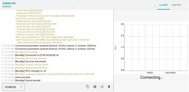

I am trying to perform a FOTA upgrade over BLE with an nRF52832.
I started with the zephyr sample "peripheral_dis" at zephyr/samples/bluetooth, and then followed all the steps here:
https://developer.nordicsemi.com/nRF_Connect_SDK/doc/2.1.2/nrf/ug_nrf52.html#fota-over-bluetooth-le

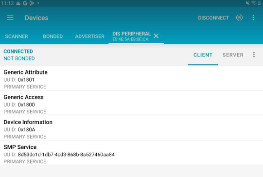

I'm using the app nRF Connect on my tablet, when connecting to my device I see the DFU option and then I select the app_update.bin file.
it gets stacked in "Connecting".

It's the first time I try this so I'm not sure how to continue.
