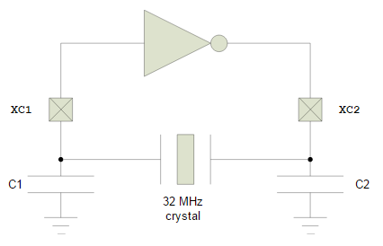

    Please see the electrical specifications for the 32MHz crystal here. Look for a crystal within the following specifications:
    • Atleast 40ppm +/- for BLE usage
    • Max 12pF load capacitance
    • ESR lower than typically 80ohms(double check this in the electrical specification as it is dependent the shunt capacitance)
    image description
    Also be aware that when you use a different load capacitance from the one used in the reference design you will need to change the capacitors C1 and C2.
    C1 and C2 should be the same value and are calculated like this.
    C1 = C_L * 2 - 4pF
    That means that if you have a load capacitance C_L of 12pF you should use 20 pF for your C1 and C2 capacitors. If you end up with a capacitor off the E12 scale etc that you have available, switch to the one that is the closest approximation.
    This means that either of the ones you have suggested will work.

  • Hi found the crystal on digikey with CL 8pf and frequency tolerance 30ppm.
    www.digikey.ca/.../en
    This would work fine?
