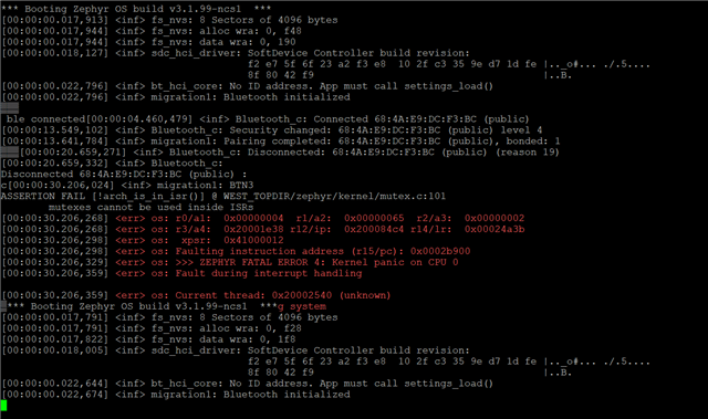

  • I tried your suggestion but it didnt work. When I tried out what you suggested, the bonding failed. These are the logs.
    <inf>: Connected 68:4A:E9:DC:F3:BC (public)
    <wrn>: Security failed: 68:4A:E9:DC:F3:BC (public) level 1 err 4
    <inf> migration1: Pairing failed conn: 68:4A:E9:DC:F3:BC (public), reason 4
    <inf>: Disconnected: 68:4A:E9:DC:F3:BC (public) (reason 19)
    <inf>:Disconnected 68:4A:E9:DC:F3:BC (public) :
    I am sure it must be a mistake on my side. Can you please take a look at this ? Isn't this how you suggested that I do ? Just to make sure that we are not misunderstanding each other, I am using NCSv2.1.0 and for testing purposes, I have switched to the basic peripheral UART example. So the characteristics of that particular service applies now. What I am testing is if I can bond with the peripheral without a passkey. I am not trying to access any particular characteristic. I just want to bond with the peripheral straight away.

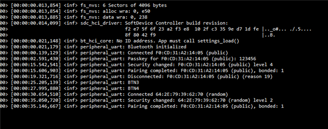

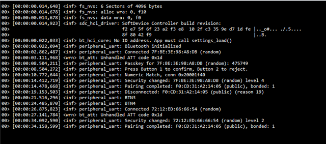

  • Please try the attached project with static passkey. I tested here and it worked fine.
    peripheral_uart_changebond2.zip
    6406.zephyr.hex
  • I tested the attached configuration and it works fine. I think I now understand the issue. The test procedure is incomplete. The following is the test sequence that gives the error.
    Pair using static key - SUCCESS
    Disconnect
    Button 3 (or some function to unpair )
    Button 4 ( or some function to switch to Just Works)
    Pair again - SUCCESS
    Disconnect
    Button 4 ( or some function to switch BACK TO fixed passkey ) - ASSERT
    Attempt to pair - FAILURE
    The below is a very crude form of the test setup. Sending 'h' through UART, makes the module switch to fixed passkey and sending 'c' through UART makes it switch to Just Works.
    I think this would show the failure condition. Can you please try this one? Please forgive the mess in the attached code. I have been trying a lot of things.

  • I know what caused the issue. It is the bt_unpair() at top level that causes the issue. I debugged a bit and as far as i can tell, it traces back to settings_delete() in C:\ncs\v2.1.0\zephyr\subsys\settings\src\settings_store.c. Please see the attached log. The error happens when one switches from passkey to justoworks and then to passkey.  The settings-delete() invokes a settings_save_one() which employs mutex. I believe that operation inside the mutex lock is what is causing the issue.
    =~=~=~=~=~=~=~=~=~=~=~= PuTTY log 2023.01.02 11:19:40 =~=~=~=~=~=~=~=~=~=~=~=
    switching to justworks
    Deleting key bt/keys/487cd2692fe81 settings_delete()
    68:4A:E9:DC:F3:BC (public) (keys 0x0022)
    Deleting key bt/keys/684ae9dcf3bc0settings_delete()ASSERTION FAIL [!arch_is_in_isr()] @ WEST_TOPDIR/zephyr/kernel/mutex.c:101
    	mutexes cannot be used insidhe ISRs
    hhhhhhhh*** Booting Zephyr OS build v3.1.99-ncs1  ***
    Starting Nordic UART service example
    switching to passkey
     bt_gatt_clear()
    bt_gatt_clear_ccc() settings_delete()
  • Could you try my attached code. I added the following code for Button2 to switch back to passkey:
        if (buttons & DK_BTN2_MSK) {
                LOG_INF("BTN2");
                bt_passkey_set(passkey);
                bt_conn_auth_cb_register(NULL);
                bt_conn_auth_cb_register(&conn_auth_callbacks);
    And I can switch between bond modes back and forth multiple times.
                LOG_INF("BTN2");

    	if (buttons & DK_BTN3_MSK) {
    			LOG_INF("BTN3");
    			bt_unpair(BT_ID_DEFAULT,NULL);
    	if (buttons & DK_BTN4_MSK) {
    			LOG_INF("BTN4");
    			bt_passkey_set(BT_PASSKEY_INVALID);
    			bt_conn_auth_cb_register(&conn_auth_callbacks2);
    			//bt_unpair(BT_ID_DEFAULT,NULL);
    			LOG_INF("BTN2");

    Note that I don't use CONFIG_BT_SMP_ALLOW_UNAUTH_OVERWRITE
    Whatever I try, it all ends in the same error message. And I always trace it back to the settings_delete() in C:\ncs\v2.1.0\zephyr\subsys\settings\src\settings_store.c. Please go through the latest logs attached. There are some custom minor changes but the overall workflow and process is still the same.
    I have no idea why this does not come up in any of your tests though. I have tried different projects, different methods and even different devices and it all ends the same way. Can you please help me figure this out ?
    Edits:
    I dont use that either.
    However, please note that I am using NCS v2.1.0
    Also, since I believed that the mutexes in the settings_save_one() which is invoked by the settings_delete(), I tried commenting out the invokes to settings_delete() to check if there was a change in situation and it worked. There was no more of this error and I could switch back and forth. This strengthened my belief that there might be something happening around that part. But that does not explain why I am the only one with issue though.

    I had tried with v2.2.0 too and there were no changes to my observation. Using buttons do not always create a problem but I have observed problems when I switch back and forth for long times though. You see, ultimately what I want in this project is to control the switching with UART commands on a custom board.Hence, even in the devkit I try to use a similar feature (i.e UART controlled BLE mode switching.) As such, it is of little consequence to me beyond debugging purposes that whether this works fine with buttons. I hope you get the bigger picture. A new problem now is that the buttons in my DK are not working fine as it used to before.
    You mentioned you tested on different devkit and got the same result
    Not different devkits, different devices. I tried it on another nrf52840 and got the same result.
    If you test with my code without any modification do you have the same issue ?
    The last time I checked, it was working fine for a majority of cases except when there was a huge number of switching back and forth between modes. But as I told, that is not something I really want.

    Erasing a page in flash taking time, can be up to 90ms. I wouldn't suggest to queueing a lot of erase command in a short period of time.
    If the bond is already erased you don't need to erase the bond again to switch the pairing method.
