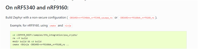

    Both psa_crypto and ECDSA samples work on RF5340's application core only.
    As you said ''In the list of connected devices (for both examples) I see VCOM0 and VCOM1 (I did not use the RTT). I have connected to each after the other and each time resetting the nRF5340 DK.'' It may not correct for these samples as both (https://developer.nordicsemi.com/nRF_Connect_SDK/doc/latest/zephyr/samples/tfm_integration/psa_crypto/README.html#on-nrf5340-and-nrf9160) ,(Crypto: ECDSA — nRF Connect SDK 2.1.99 documentation (nordicsemi.com)) need to be built on only app core. So, you should try only the second COM port for this sample. As second port outputs the log from the application core.
