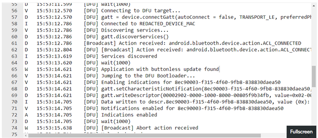

I'm developing on the current setup:
  • nRF52833 DK, emulating an nRF52820.
  • Soft Device 113 version 7.2.0
  • SDK 17.1.0, with updated MDK (see link)
  • IAR EW ARM 9.30
I'm having issues with the DFU on my project. I included the secure bootloader based on example "\examples\dfu\secure_bootloader\pca10100e_s112_ble".  I'm also having a different issue related to the debugger which can be found here, in case they're related.
The linker configuration for the bootloader project is:
/*-Specials-*/
define symbol __ICFEDIT_intvec_start__ = 0x38000;
/*-Memory Regions-*/
define symbol __ICFEDIT_region_ROM_start__   = 0x38000;
define symbol __ICFEDIT_region_ROM_end__     = 0x3dfff;
define symbol __ICFEDIT_region_RAM_start__   = 0x200022c8;
define symbol __ICFEDIT_region_RAM_end__     = 0x20007fff;
export symbol __ICFEDIT_region_RAM_start__;
export symbol __ICFEDIT_region_RAM_end__;
/*-Sizes-*/
define symbol __ICFEDIT_size_cstack__   = 2048;
define symbol __ICFEDIT_size_heap__     = 0;
And the application linker configuration is:
/*-Specials-*/
define symbol __ICFEDIT_intvec_start__ = 0x1C000;
// FLASH
define symbol __ICFEDIT_region_ROM_start__   = 0x1C000;
define symbol __ICFEDIT_region_ROM_end__     = 0x37fff;
// RAM
define symbol __ICFEDIT_region_RAM_start__   = 0x20003DA8;
/*-Sizes-*/
define symbol __ICFEDIT_size_cstack__   = 3072;
I generate the dfu settings and package with the following commands (note I'm using everything as if it were the nRF52820, whereas I'm actually flashing on a nRF52833 DK)
nrfutil settings generate --family NRF52QFAB --application app.hex --application-version 0 --bootloader-version 0 --bl-settings-version 2 dfu_settings.hex
nrfutil pkg generate --hw-version 52 --application-version 0 --application app.hex --sd-req 0x0102 --key-file private.key dfu_package.zip
This appears to work fine: the app executes and I can connect and communicate. However, the DFU fails when I run it for some reason, nRF Connect Desktop crashes and the Android version gets stuck in a loop of starting, connecting, etc.
What I can see on the nRF is this:
  • On the event handler passed to "ble_dfu_buttonless_init" I get the BLE_DFU_EVT_BOOTLOADER_ENTER_PREPARE event
  • I get the "In ble_dfu_buttonless_bootloader_start_finalize" log message
  • Then the BLE_DFU_EVT_BOOTLOADER_ENTER event.
  • Then, on the power management handler registered in "NRF_PWR_MGMT_HANDLER_REGISTER( app_shutdown_handler, 0 );" I get the NRF_PWR_MGMT_EVT_PREPARE_DFU event and I return true.
  • After that, what I see on the RTT Viewer is that the App starts again. I don't know to what extent the bootloader is executing, if at all. I tried adding logging to the bootloader but ran out of memory.
The nRF Connect for android (4.26.0) gets stuck in a loop printing the following messages:
  • Starting DFU
  • Starting bootloader
  • Connecting
This is the log output:

W	15:53:03.188	[DFU] Application with buttonless update found
V	15:53:03.188	[DFU] Jumping to the DFU Bootloader...

D	15:53:10.527	[Callback] Connection state changed with status: 8 and new state: DISCONNECTED (0)
E	15:53:10.527	Error 8 (0x8): GATT CONN TIMEOUT
I	15:53:10.527	Disconnected
E	15:53:10.535	[DFU] Connection failed (0x08): GATT CONN TIMEOUT
W	15:53:10.536	[DFU] Retrying...

I	15:53:13.619	[DFU] Services discovered
D	15:53:13.620	[DFU] wait(1000)
W	15:53:14.621	[DFU] Application with buttonless update found
V	15:53:14.621	[DFU] Jumping to the DFU Bootloader...
V	15:53:14.621	[DFU] Enabling indications for 8ec90003-f315-4f60-9fb8-838830daea50
D	15:53:14.621	[DFU] gatt.setCharacteristicNotification(8ec90003-f315-4f60-9fb8-838830daea50, true)
D	15:53:14.621	[DFU] gatt.writeDescriptor(00002902-0000-1000-8000-00805f9b34fb, value=0x02-00)
I	15:53:14.705	[DFU] Data written to descr.8ec90003-f315-4f60-9fb8-838830daea50, value (0x): 02-00
V	15:53:14.705	[DFU] Notifications enabled for 8ec90003-f315-4f60-9fb8-838830daea50
A	15:53:14.705	[DFU] Indications enabled
D	15:53:14.705	[DFU] wait(1000)
W	15:53:15.638	[DFU] [Broadcast] Abort action received
W	15:53:15.711	[DFU] Upload aborted

It looks like either the bootloader is not executing at all or it's encountering an error and going back to the application. What could be the issue here?
Thanks for the help!
Thank you!
  • Hi Federico,
    It seems that the application managed to jump to the bootloader but then the bootloader rejected the DFU image:
    We need to check why it doesn't want to do DFU update.
    My suggestion to test is not to start with the buttonless example.
    Please try the following:
    1. Flash only softdevice + bootloader. Try to do DFU update a ble_app_hrs for example.
    2. Flash softdevice + bootloader + ble_app_hrs + bootloader setting. Create a new image of ble_app_hrs and create a new DFU .zip file with incremented firmware version. Try to do DFU to update to this new ble_app_hrs via FOTA. You can enter DFU mode by holding a button when reset.
    3. Flash softdevice + bootloader + buttonless application + bootloader setting. Create a new image of buttonless application with new firmware version and create a .zip file. Do DFU update.

    I tried what you said in step 1: "Flash only softdevice + bootloader. Try to do DFU update a ble_app_hrs for example".
    I did this with "ble_app_uart_pca10100_s112" instead of ble_app_hrs because it supports PCA10100e. For the bootloader image, I compiled the secure_bootloader example "secure_bootloader_ble_s112_pca10100e". This worked without issue. I flashed it, saw the device as DFUTarg, ran the DFU and ended up with a device "Nordic UART". So that worked.
    I then tried to do the same thing with my bootloader hex file but it didn't work. I can't see the device as DFUTarg. This is very interesting, because my bootloader code basically has zero differences from the  example "secure_bootloader_ble_s112_pca10100e". The two differences that I can see are: the public key and the soft device. I changed the softdevice to 113 instead of 112 to have DLE. The way I did this was to change the includes in the preprocessor from 112 to 113, change the define from S112 to S113 and swap the soft device binary. Is this correct? Or did I miss something? Could this be the issue?
    EDIT: I went back to SoftDevice 112 on my bootloader code and now I can see it as DFUTarg, so this seems like the obvious reason, I must've forgotten something when changing the soft devices. What do I need to do to change the "secure_bootloader_ble_s112_pca10100e" example to be able to run with S113? Keep in mind I'm using the 52833DK emulating a 52820.
    Thanks!

  • Hi Hung,
    Found it. It was the bootloader linker file, there was not enough RAM allocated for the SoftDevice. Since I migrated the project from a S112 example, the linker was set for that amount of RAM:
    After migrating to S113, it appears that amount of RAM is not enough. So I changed it to what the secure_bootloader example has for this SoftDevice (which is exactly what nrf_sdh_ble_enable returns). Now DFU is successful. As the bootloader project doesn't have a log, I didn't see the error as you'd see in app when starting the SoftDevice fails.
    The new config is:
    define symbol __ICFEDIT_region_RAM_start__   = 0x20002608; /* This is taken from calling nrf_sdh_ble_enable(), calculated at runtime by the SoftDevice. */
    Thank you!
