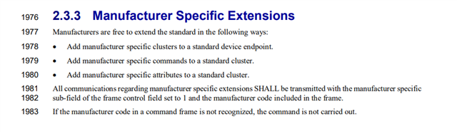

AHaug what version of the stack is the screenshot? do you have a link to them?
The screenshot is from the ZigBee Cluster Library specification (ZCL) v7, which can be obtained from the Connectivity Standard Alliances (formerly known as the Zigbee alliance) pages: https://csa-iot.org/developer-resource/specifications-download-request/. You might need to become an adopter member to get access to the documentation, which should only be a matter of registration and not require any fees.
I know that version 7 is what we support in our SDK, and I'm investigating if we're supporting v8 at this point in time.
