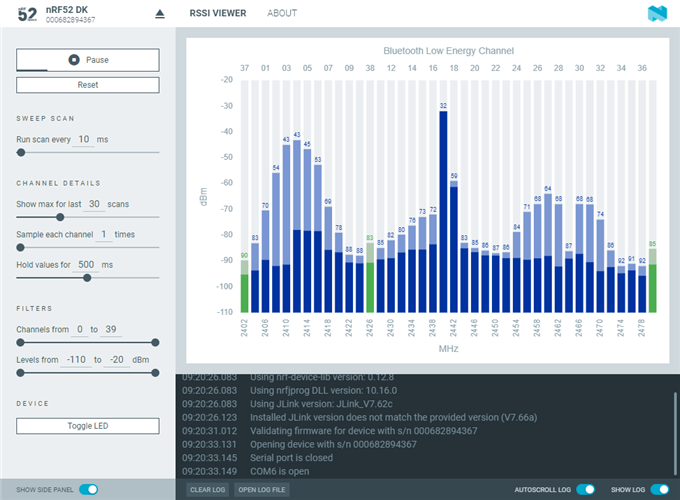

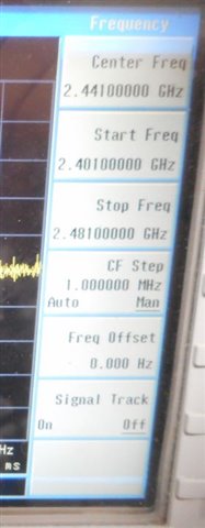

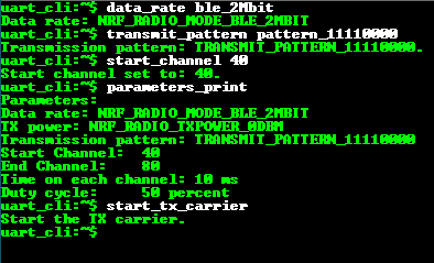

Hi all,
I am trying to certify a device with an nRF52832. No issues with US and EU, but for Japan we need to have a constant transmission on channel 17 (2440 Mhz). I attempted to use the "Radio Test" example (modulated and unmodulated TX) and the "Direct Test Mode" app from SDK 17.1.0. Both apps produced transmissions that our test house called "too wide". We tried both our custom device and a development kit, but both produced the same result. Below is an image of readings from two devices, one with with advertisement channels transmitting and another with channel 17 transmitting. Our goal is to have the transmission on channel 17 be a similar width to the advertisements. Is there something I am configuring wrong, or using the wrong test application? Any help would be appreciated.
