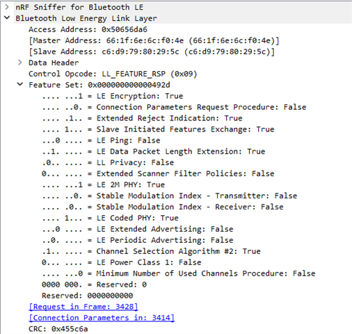

But when sniffing the packets I find that LL Privacy (and some others) are not supported in the LL_FEATURE_RESPONSE:
Am I missing some dependency missing?
