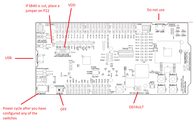

I've been trying to flash the NRF5340 from my M1 Mac for a few hours now. But every time I get only the above error and that I should contact Nordic if the error persists.
The flashing is done via the JLink Base with version 1.1.0. This is connected to the Mac via USB. I have already tried it with 3 NRF5340 boards. With my Windows colleagues they work.
How do I get the flashing to work? I have attached a log. My setup is as follows:
- MacBook Pro M1 Pro
- MacOS Venutra 13.0.1
- nRF Connect for Desktop v3.12.1
- nRFConnect SDK v1.9.1
- nRF Command Line Tools 10.18.1
- JLINK V66a Universal --> because otherwise the programmer grumbles. But also with the newest V7.82d Universal the identical error occurs.
- nRF Connect for VSCode v2022.11.40
- NRF Connection for VS Code Extension Pack v2022.9.6
When I start the programmer in nrRF Connect I don't even see the JLink. There is always only I should buy a Nordic Development Kit.
In Visual Studio Code (both ARM and x86 variants), when flashing, I get the above error.
Thanks for your help!
Nils
