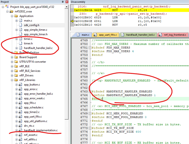

    I see that the hardfault handler is reached, but it is not easy to see much more from the video. I suggest that you add the hardfault handler from the SDK HardFault handling library and enable logging. To use it, set HARDFAULT_HANDLER_ENABLED to 1 in sdk_config.h. Also, make sure you have hardfault_implementation.c and hardfault_handler_iar.c and that components/libraries/hardfault/ is in your inlude path. Then enable logging. Then the log will provide information on the hardfault so that we know more where to look closer.

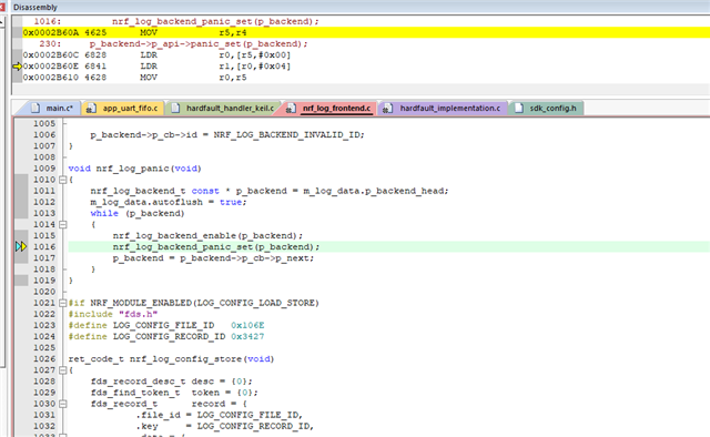

  • Good morning, I hope you had a nice weekend. Yes you are right about the HardFault handler. It does get reached and enters this mode. I have set the HARDFAULT_HANDLER_ENABLED to 1 and added hardfault_implementation.c. I added hardfault_handler_keil.c because I am using the keil compiler. I'm not quite sure about how to use the HardFault_handler function tough. Is it a replacement for the main function. Do I have to add it to some callback? My main.c file still looks the same as befor. The diffrence is that the exception no breaks at screenshot 2. I'm not sure how to progress from here. Thanks for the patience. Best regards Maikel
    As long as you added the two implementation files and enabled HARDFAULT_HANDLER_ENABLED in sdk_config.h that should be used (the default HardFault_Handler in the startup file is weak, so simply adding another will cause that to be used). There is no need to make any other changes in your project or code in order to use it. Is the hardfault handler from the library not reached now?
    That is good, as it should.
    The new hardfault handle use logging, so if you have logging enabled it should be enough to observe the log output to see info about the hard fault (if you don't have logging enabled, consider enabling it - it is often very usefull for debugging). If you are not able to get logging working you could set a breakpoint in the HardFault_c_handler() function and inspect it manually to find the info that would normally be printed in the log.
  • Ok, thanks for the info. I have enabled the Logging feature. I'm using the J-Link RTT. The NRF_LOG_INFO() macros are getting called in the regular functions. The hardFault handler function are not getting invoked however. I added a debug point at the start of the HardFault_c_handler() function. No responds.
    I see. Are you still reaching the other (default) hardfault hander? If so, it would indicate that either some of the two needed files are missing, or that HARDFAULT_HANDLER_ENABLED is not set to 1 in sdk_config.h, or that there is no hardfault at this point.
