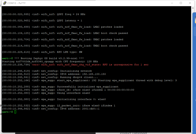

  • Did you test the example of shell or radio_test,I can't run these examples on nRF7002-PDK.
    The 7002 build code is N7002QFAAAA.
    The 5340 build code is N5340QKAAD02042AA
    PCA10143 version is 0.2.1 2022.36

  • Hi Pony and Paul!
    So, the nRF7002-PDK has had a revision A and revision B release. It turns out that NCS v2.2.0 configures the firmware for revision B by default, and it is not backwards compatible with revision A.
    To fix this issue, set the following Kconfig flag to configure the revision A firmware:
    CONFIG_NRF700X_REV_A=y
    That should do it.
    Raoul
  • Hi Raoul,
    This issue has been solved. Thank you very much!
