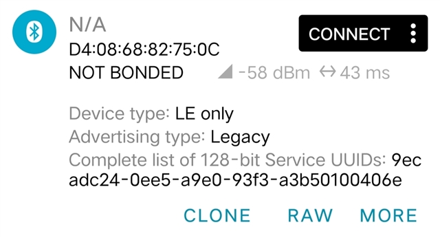

I have met a problem that I try to advertise nRF52840 dongle in pc-ble-driver-py. However, connection is not built from this command:
BASE_UUID = [0x6E, 0x40, 0x00, 0x01, 0xB5, 0xA3, 0xF3, 0x93,
                                 0xE0, 0xA9, 0xE5, 0x0E, 0x24, 0xDC, 0xCA, 0x9E]
adv_data = BLEAdvData(service_128bit_uuid_complete=BASE_UUID)
The uuid is uart over ble which is used in nRFConnect desktop. And we can connect through this application.
I wonder to know how to advertise with specific 128bit uuid by pc-ble-driver-py. Thank you!
  • I find that this code can not change the complete list of 128-bit service uuids. Is there any function which can change the uuid of the advertising device?

  • zhaoyuan said:
    This function self.adapter.driver.ble_vs_uuid_add still doesn't work.
    What do you mean by "doesn't work"? Are you getting any errors?
    I don't get any error. But the uuid has not changed, which can be seen in complete list of 128-bit service uuids.
