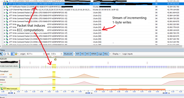

I found that if I send enough Characteristic Writes while the nRF52832 is doing the ECC computations, I can cause one of two effects, based on how I've configured the size of the App Scheduler. If it is 50, app_sched_event_put() in SD_EVT_IRQHandler() returns NRF_ERROR_NO_MEM. If it is 60, then I instead see NAKs from the SoftDevice to the Central on my BT sniffer.

    Then why do my sniffer captures appear to imply that the SoftDevice absorbed 45 packets here?

  • I was using a stream of incrementing packets specifically so I could check whether the application receives each one. It does. None were lost. So, they must have been buffered during the ECC computations. The application was not polling the SoftDevice, so they must have been buffered within the SoftDevice's memory.
