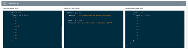

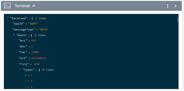

I can see the AGPS message on the nRF Cloud dashboard:
I also see that nRF Cloud sends an error message to the device:
I suspect that the JSON packet that request AGPS data is not correctly formatted... am I correct? Does this have to do with the modem FW version? When I started to evaluate the Thingy:91 I programmed v1.3.2 but I see that there is a newer version v1.3.3

  • If it helps, here is the format of the JSON msg (note that MCC is 655 and MNC is 1 for the contract SIM that I'm using):
      "appId": "AGPS",
      "messageType": "DATA",
      "data": {
        "mcc": 655,
        "mnc": 1,
        "tac": 21001,
        "eci": 243210529,
        "rsrp": -140,
        "types": [
          1,
          2,
          3,
          4,
          6,
          7,
          8,
          9

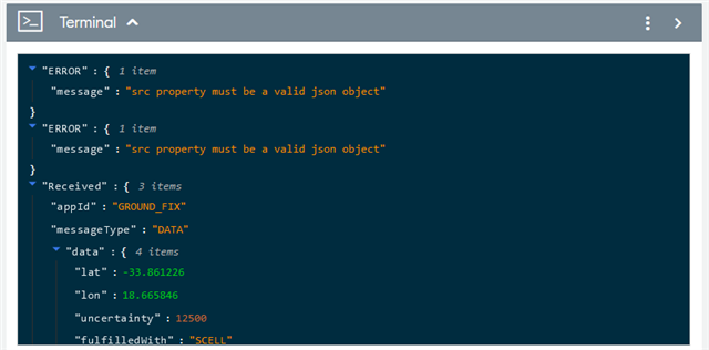

    And here is the response from the server:
      "message": "src property must be a valid json object"

    And here is the screenshot of the nRF Cloud dashboard where the same error is reported to the device:
    So in short: no, upgrading to the latest release does not fix the problem.

  • Hi, Pieter,
    I was able to recreate identical behavior on one of my work devices.
    It turns out, though, that despite the errors in the c2d column, AGPS responses actually are sent to and processed by my device. And I suspect the same is true of yours!
    To check, add
    -DCONFIG_NRF_CLOUD_GPS_LOG_LEVEL_DBG=y
    to your build arguments when building ATV2.
    If it works, you should see output from the agps_send_to_modem function in nrf/subsys/net/lib/nrf_cloud/src/nrf_cloud_agps.c
    For instance, here is a snippet of what some of mine look like:
    [00:00:20.305,511] <dbg> nrf_cloud_agps: nrf_cloud_agps_process: TOW 25 copied
    [00:00:20.305,541] <dbg> nrf_cloud_agps: nrf_cloud_agps_process: Parsed_len: 1095
    [00:00:20.305,572] <dbg> nrf_cloud_agps: nrf_cloud_agps_process: TOW 26 copied
    [00:00:20.305,572] <dbg> nrf_cloud_agps: nrf_cloud_agps_process: Parsed_len: 1099
    [00:00:20.305,603] <dbg> nrf_cloud_agps: nrf_cloud_agps_process: TOW 28 copied
    [00:00:20.305,633] <dbg> nrf_cloud_agps: nrf_cloud_agps_process: Parsed_len: 1103
    The presence of output from this function like this indicates that a valid AGPS response was received by the device from nRF Cloud.
    As for CLOUD_WRAP_EVT_AGPS_DATA_RECEIVED, we have recently (in 2.2.0) transferred the responsibility for calling nrf_cloud_agps_process away from the application, and integrated it directly into the nrf_cloud library. Thus, the CLOUD_WRAP_EVT_AGPS_DATA_RECEIVED is never actually called.
    Finally, regarding the errors you see in c2d, those are benign and can be ignored. In fact, they appear to be directly caused by the AGPS responses themselves, rather than an indication of failure! We are looking into why errors are being raised, but at first glance it seems our FE is misinterpreting the raw binary AGPS payloads as invalid messages. The AGPS payloads are still sent to the device, however, and you can confirm they are successfully received using the suggested check above.
    Thanks for investigating and the tip regarding CONFIG_NRF_CLOUD_GPS_LOG_LEVEL_DBG Slight smile
