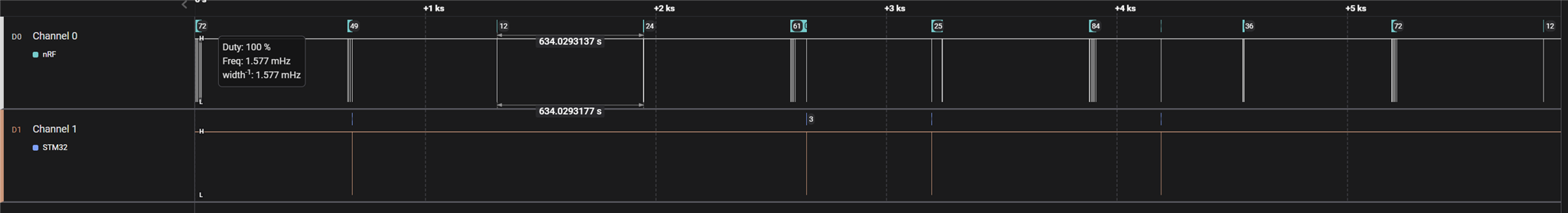

Since the MPSL is completely opaque, I really have no idea what's going on here. My best guess is that some time critical behavior is being violated, but I am not sure what. I'm also not sure what to do about it, since the flash erase and write times are essentially out of my control.
  • Hieu,
    Of course. We started with the Mesh and Peripheral Coexistence sample. We replaced the light button service with our own service (which is fairly similar to the NUS), replaced the mesh model with our own model, added a serial connection to the host processor on our system, and enabled CONFIG_DFU_TARGET_MCUBOOT=y. We then use serial commands to write packets of the update image to flash. These are handled by an application thread which is reading from a ring buffer populated using the async serial API.
    I want to add that we seem to be having issues with delayable work/timeouts in the async serial uarte driver and the bluetooth mesh extended advertiser. Essentially, it seems like the timeout takes an entire RTC counter wrap around to occur. I'm going to trial using the SysTick as a source to see if the behavior is within the RTC timer driver. It may be related, but I don't see the MPSL assertion when we are not writing to flash.
  • Peter,
    I plan to replicate your issue here and try some debugging. It seems I will make do with the Mesh and Peripheral Coexistence sample as is then.
    Could you please give some more details on the "added a serial connection" part? Which peripheral (1/2/3) did you use, and what Kconfig and DTS config did you set it up with?
    If you feel like it can be quite complicated to replicate your issue, please let me know if you want to send us your project.
  • So I've had success today after switching from the nrf RTC timer to the systick for the system tick source. Is there a known issue with the RTC timer in ncs 2.1.2?
  • Sorry but I am not clear about/familiar with what you changed here. Could you please give some further details?
  • Essentially, I added the following to our prj.conf file. We had no issues with the debugger connected after making this change. However I'm now running into an issue where the kernel tick count is not being updated until the RTT is connected. Very strange. Either way, I would have expected the RTC timer to work correctly out of the box. However, there seems to be an issue where timeouts can be evaluated on the 2^24 - 1 tick after the current one, for whatever reason. It appears something like that must have been interfering with the MPSL as well, it would seem.
    CONFIG_NRF_RTC_TIMER=n
    CONFIG_CORTEX_M_SYSTICK=y
    CONFIG_SYS_CLOCK_TICKS_PER_SEC=10000
    CONFIG_SYS_CLOCK_HW_CYCLES_PER_SEC=64000000
  • By "kernel tick count is not being updated," do you mean k_uptime_get() and k_uptime_ticks() return 0?
  • Not exactly. Timers are not executed in real time. k_uptime_get() reflects that the ticks counted by the system are less and are proportional to the timer execution. For example, a 5 second timer will take ~40 seconds to execute, and k_uptime_get() between those two times reflects that the kernel ticks have only advanced 5 seconds.
    Once RTT is connected to read log messages, the ticks advance normally. This appears to continue after disconnection of the RTT as well.

    I have not tested the SysTick on the current Zephyr main branch. Since reducing the value for CONFIG_SYS_CLOCK_TICKS_PER_SEC to 2048 seems to solve the timer delay issues I've been observing, I have been trying to focus on the nrf RTC issues which prevent it from operating as intended. The weird SysTick behavior is probably a hardware mistake on our side. I'd like to track it down, but I can't seem to reproduce it on dev kit hardware, so I think it would be hard for you to reproduce on your end.
    Truthfully, I really don't know what's going on. In the past I put in log messages to verify that the Bluetooth mesh extended advertiser was requesting a reasonably short delay for the work; it never requested an interval of zero or one greater than tens of milliseconds. Yet, I have seen the work take hundreds of seconds to be operated on. This is a catastrophic bug that I can't believe exists in something like ncs. I'm hesitant to believe that it is, since we wouldn't be the only ones having this issue and from what I know ncs is used all over the place. I'd be happy to accept that it's an issue with our project configuration or hardware, but we're not doing anything the device wasn't advertised to do, and it seems to be reproducible on development hardware.
