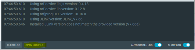

  • Here's the programmer log in verbose mode when I did an "erase all" and loaded the HRS app. After loading the app, none of the LEDs are lit except power and the board is not advertising.
    09:45:26.998	Using nrf-device-lib-js version: 0.4.13
    09:45:26.998	Using nrf-device-lib version: 0.12.8
    09:45:26.998	Using nrfjprog DLL version: 10.16.0
    09:45:26.998	Using JLink version: JLink_V7.80c
    09:45:27.028	[nrfdl][warning](09:45:27.027) [JlinkARM] JlinkARM version non expected one found: JLink_V7.80c, expected: JLink_V7.66a
    09:45:27.028	Installed JLink version does not match the provided version (V7.66a)

    Please try to reset the board after writing the image.
    I see the same issue as you, but pressing the reset button on DK can help.
    -Amanda H.
  • I always power-cycle the board after I flash it, which I believe resets the board. I also did another reset after power-cycling and the board is still not advertising. Did your board advertise after reset?
